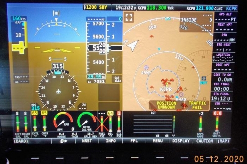

5/10/20
4.0 Hours
Trouble shot the EGT, fuel pressure and coolant temp sensors for not showing on Dynon. Only got the EGT to work. The plug pins were mapped wrong. Wiring for coolant temp seems to be OK. Wrong sensor mapped for fuel flow but still doesn't work. Sent query to Dynon.
5/11/20
2.8 Hours
Continued with the trouble shooting. For the coolant temp, it turned out to be a display issue, i.e. the wrong info was chosen to be displayed. Corrected that. Now, the only display issue is the fuel pressure.
5/12/20
3.1 Hours

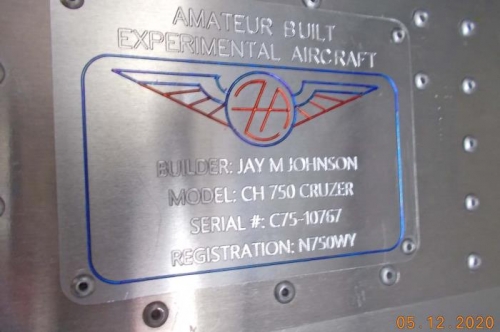

Checked another idea I had during the night about the fuel pressure display.Re did display to match the 15 PSI sensor and Rotax's. Still no go. Sending a query to Dynon. Riiveted the data plate that I got from mykitairplane.com onto the left side of fuselage below the stabilizer. Re-set the prop pitch to 9 1/2 deg.(was at 9)
Everything working except fuel pressure
Data plate riveted
Data plate riveted
