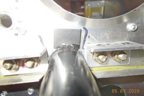

Finished the fourth turnbuckle for the control cables. Torqued the eight exhaust bolts to 133 in-lbs in steps. Removed bolts that hold torque tube bearing to be able to add the flaparons control stops. Did most of the access from the top through the central channel.
5/7/20
2.7 Hours
Leroy Dunn of Natrona Avionics certified transponder and received log book sticker. Tightned bolts on flaperon control stops. Clecoed rear center channel cover into place.
Flaperon stops
Flaperon stops
