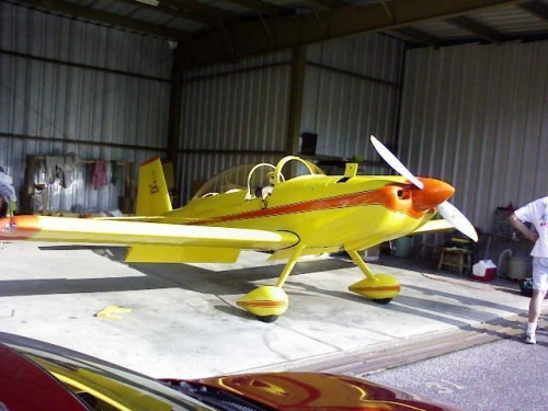

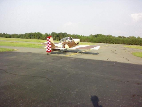

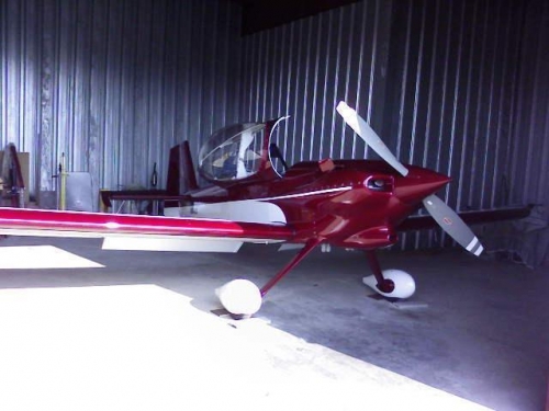

Had Labor Day off today, so I did some flying with some local SH RV bubbas. Flew as -3 of a 4 plane with Mike DeMarino in his super fast RV-4. After the flying was done and the birds put to bed, Jere Rosser, my EAA Technical Counselor came by for a visit. He has just completed his 3rd project; KR-2 (Tweety Bird 1), RV-4 (Tweety Bird 2), RV-8 (Tweety Bird 3). He has also completed a major restoration of a B-25 and is just a wealth of knowledge. His plane is shown in the pics, and can't be missed with his signature "Tweety Bird" yellow paint scheme.
He is flying the Aero Sport 180 with the new Hartzell blended airfoil prop, He says it flies like a dream.
