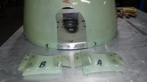

Brief Description:  Spinner Fillers
The spinner fillers were finished today. The backer plates were trimmed and sanded to size, and the rivet holes were countersunk. Epoxy was applied to the overlap area of the backers and fillers, and they were riveted together with soft rivets.
The outer surfaces of the spinner and fillers were sanded and prepared for priming. I’ll pick up some sandable primer in the morning and begin the process.

Spinner Fillers Ready for Priming
