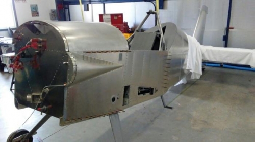

Date:  3-21-2017
Number of Hours:  6.50
Brief Description:  Final Assembly - Left Side
Today the left skin was temporarily clecoed in place to make sure everything was copacetic before riveting the skin on. No issues were apparent, so the skin was removed; sealant was applied to the airframe, and the skin clecoed in every other hole.
Stainless steel, CCC-42 and CCC-44, rivets were applied where the skin is riveted to the steel framework, and aluminum rivets elsewhere. I was running short on CCC-44 rivets, so I left some of the clecos in place to reserve enough to start the right skin tomorrow. Additional CCC-44 are on order.
Left Side Riveting Almost Complete
