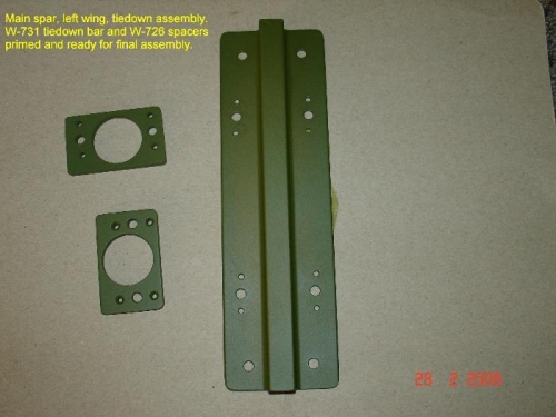

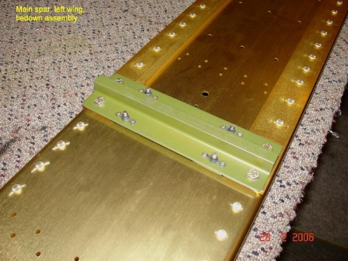

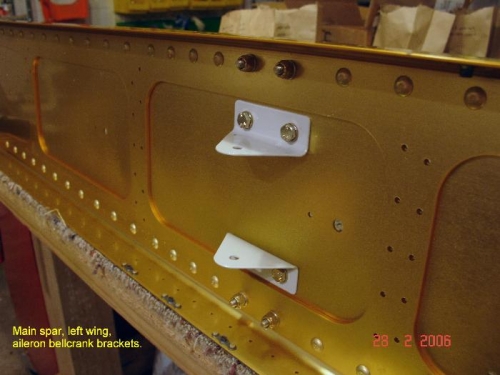

Brief Description:  Tiedown assembly (left wing)
Eventually successful but not without problems: had a blonde evening. Riveted the W-726 spacers to the W-731. Messed up three rivets and had to drill them out. Put new ones in. Then realised I had completely forgotten to put the nutplates on. Drilled out all the rivets and re-did them with nutplates. Had to replace one of those too! Bolted the tiedown assembly with the W-823PP aileron bellcrank brackets onto the spar. Torqued the AN365-1032 nuts and the AN3-6A bolts to 25 inch-lbs. So a lot of time and nothing much really completed. Ah, well, nothing major and you get evenings like that... will start on the rear spar tomorrow night.
Tiedown assembly primed
Aileron bellcrank brackets
Tiedown assembly fitted
