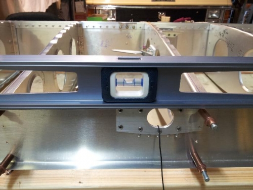

1) more leveling, but note the tie down used to hole the wing level...bailing wire with two sheet rock screws into the bench top again. If done gently so as to not deforn the spar..or other object...it seemd to work very well. way cheaper that a big clamp.

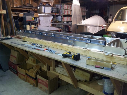

2) overall view of process

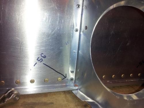

3) As mentioned before, I did indeed screw up when constructing the spar, and drilled out these top holes...and bottom ones too.. too big to use the -46 pulled rivets as speced in the plans. Sones OK'd using -56 as my remedy, and they worked well. no harm ---no fowl/foul..what ever!! I dont plan to do the same on the RH wing, however.
clecoed and leveled
clecoed and leveled
overall view
overall view
oversize hole in spar
