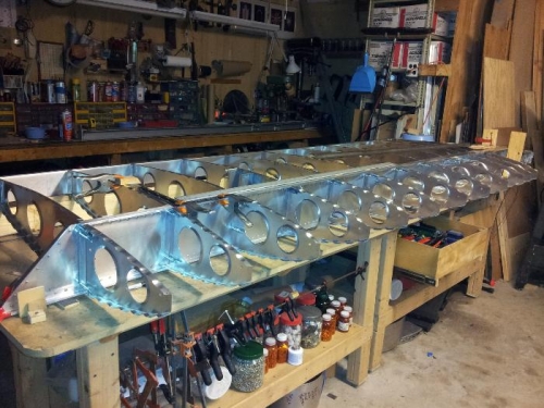

1) Still cant tell if I did rivet the spar and ribs together...sort of looks like I did.

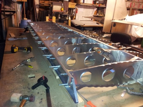

2) Front side view of progress

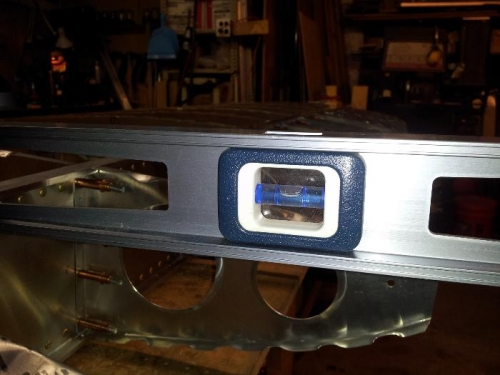

3) all leveled up!
The whole series of pix here also show that I have taked the aft to fwd bend out of the spar...because of the riveting durring assembly...about a centimeter and a half maybe? Note the blocks screwed to the bench..The bench top IS sacrificial, isnt it?? the rear spar is supported with a long 2x4 and tapered shims to assure fore/aft level. this is susposed to minimize twist. I sure hope it does, as it will be long time before I can put the fix in for it with flap adjustments if I screw up very badly here. (IE, durring phase 1 testing).
