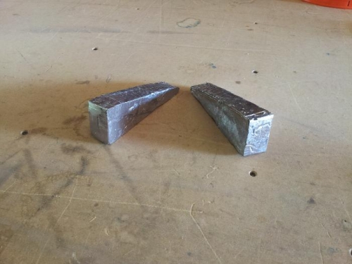

1) These are the finished weights ready for install. Trimming was a bit of learning. Cut with band saw, and if I cut fast at all, the blade would jamb up. using soap helped some. The first weight went pretty well, but the second on was a major PITA as the saw would stop. Drilling the holes cost one broken bit, several issuences of different type of words and a lot of time removing the piece. I did learn a lot about drilling lead, and finally suceeded. Oh, the lead weight would get too hot to hang on to, too. but I got them trimmed to 1.00 +/-, and with a bit of room on the top to actrually do the final weight trim at instal.

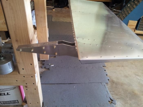

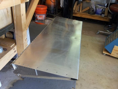

2) weights came awfully close to being perfect! the spec is bottom surface level +1/2 in up deflection. this one, LH has about 2-3 in up deflection. Too much lead. that is the way I needed it for trimming at install.
3) this is the RH and it had even more up deflection, maybe 6 in? I did not measure. All I saw was it wasnt bottom level at this point.
