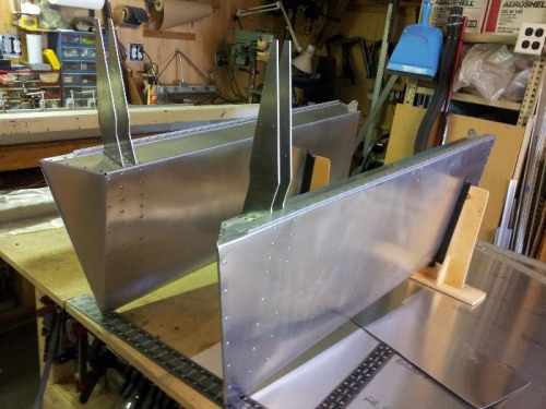

Brief Description:  finishede ailerons
1) I must have found more of them things!
2) there is two of 'em, but they are not twins! Wait a minuet...thats correct. They are morror images of eath other. that is good.

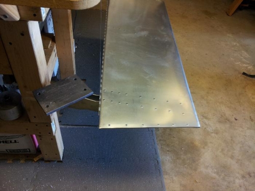

3) I took one of the finished ones, and did a little test with the lead I have in hand. I measured the weight at 4.0 lbs, and did adjust the position on the arm for a ballanced aileron. I will use the approximate weight to cast my weights at about 5 lbs so as to trim to shape slightly, or maybe a lot, depending on how thick I make them. spedc thickne3ss is at 1.00 inches, and basic triangleular shape. I am using pure lead. maybe others used lead alloy. they are not the same unit weight. pure is heavier, but not by much.

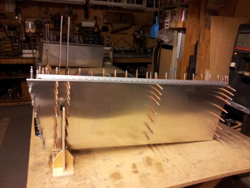

almost ready fior revits
There is two!
There is two!
test ballance
test ballance
