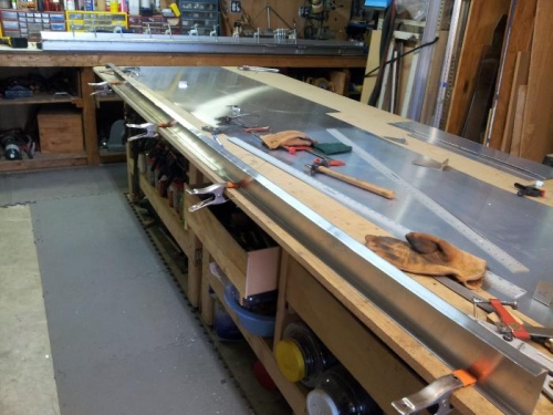

1) The second attempt went better, and here I am trimming the edge to size.

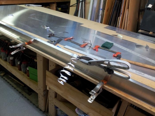

3) The afore mentioned hand shears, again trimming the edge of the spar. I also found and have to remind myself each time I trim, that if you 'force feed' the throat of the shears, and then cut, you will most likely leave a small bend in the finished edge of the aluminum. It, I think, is actually a streach mark where the closure of the jaws pulls the sluminum before it cuts. One can not undo the damage. So, each time I do this operation I mave to make an effort to not force feed.

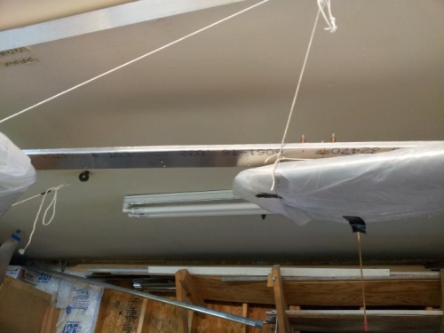

2) there be rear spars in the shop!! They are hung with great care and anticipation!!
2nd attempt
2nd attempt
spars on the tail feathers!
trimming to size
trimming to size
