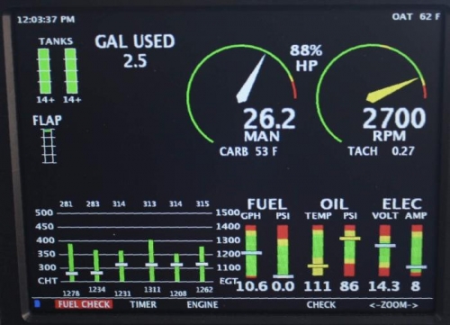

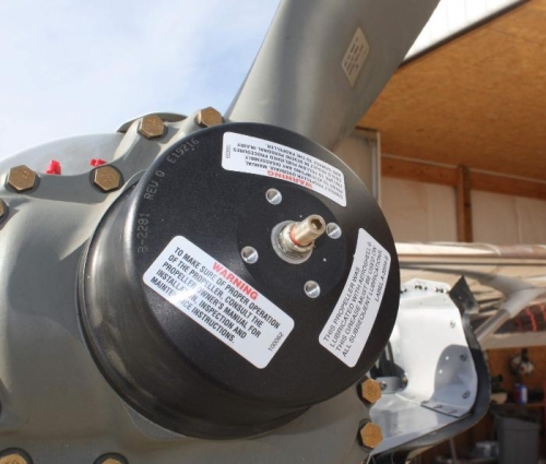

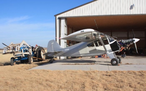

I tied the tailwheel of my aircraft to my tractor using a tow strap. Initial runup only achieved 2450 RPM with full throttle. Following Bob Barrows' instructions, I backed the governor down to the maximum possible RPM, so that the governor wasn't possibly impeding the RPM. There was no effect on max RPM. I then adjusted the static RPM using the hex bolt on the propellor hub by turning it counterclockwise about 1.75 turns, which then achieved about 2750 RPM at full throttle. I then dialed the governor back in so that it brought the prop RPM back down to 2700 RPM. I untied the aircraft and put the spinner back on and adjusted the prop cable so that full RPM will be achieved.
Tied up to tractor.
Tied up to tractor.
Static high RPM adjustment hex bolt.
Final EM screen.
Final EM screen.
