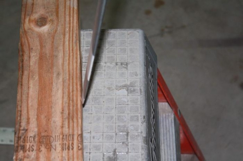

One of the items on the DAR checklist is to check prop tracking, which is one of the few things that is quick and relatively easy. I set a short length of 2x4 on my step stool, and rotated the prop through a revolution, watching where the blade contacted the board. There was no discernible variance between the three blades.
