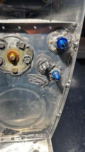

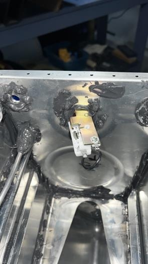

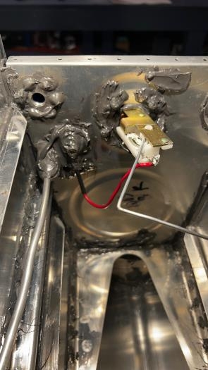

I opted out of spending $2500 for the CIES senders. I am sticking with the standard Vans SW floats. I am adding an extra fuel level sender to the ER tanks outboard side.
With that being said I had to modify the inboard sender for a series connection. Instead of 30-240 Ohm range, this way will give 60-500 range. Much more room to calibrate fuel levels on GEA24.
I installed the pass thru fitting on the inboard fuel 1003B rib. You can see it in between the sender plate and vent AN fitting. It was not to difficult but took some innovation. Others have installed it through the sender plate but I could not find one small enough to fit in that location,
I have attatched pictures. If you want to see more info on my modification please visit my YouTube channel as I made a video tutourial! @jerseypilot83
pass thru fitting in between sender and vent
new wire on sender for pass thru
inboard sender being modified for series
