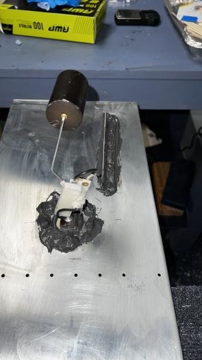

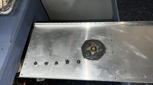

Installing OB Fuel Level Sender
Installing the OB fuel level sender for the Sky Designs ER tanks. Used modest amounts of proseal to make sure there will be no leaks.
I am using the stock Vans Stewart Warner floats.
The float arm is bent differently than inboard sender. This OB sender will have range of motion from half to full.
