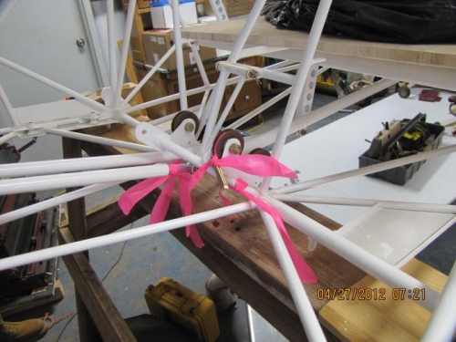

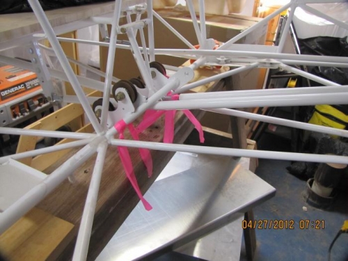

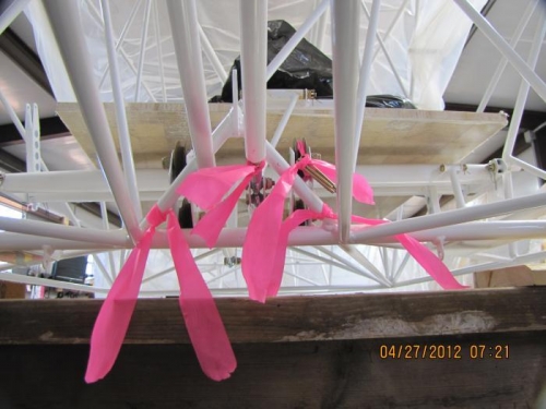

Today I installed the rudder cable pulleys. It was necessary to disconnect the center elevator control rod to install the bolts from the center out. While the elevator control rod was disconnected I took the opportunity to adjust the center control rod ends to 1/2 inch gap between the rod end and the rod itself.
The pink flagging are reminders to complete the control rod adjustments to secure and torque all the bolts involved. The final step is to add thread locking solution the nuts when finished..
Passenger side view rudder cable pulley installation.
Center and bottom view of rudder cable pulley installation.
Pilot side view rudder cable pulley installation.
