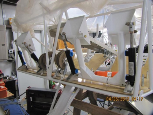

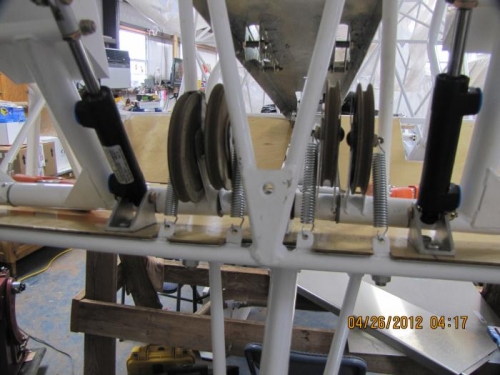

Brief Description:  Install adjustable rudder controls & brake master
The assembly manual was a bit confusing regarding installation of adjustable rudder controls. The adjustable option was further back in the manual. I did not discover it until the rudder torque tubes were already installed. It took longer to cut off the rudder control horns and install the pulleys, than had I installed the adjustable option prior to torque tube installation. After completing the the adjustable rudder, I reinstalled the brake master cylinders. We should now be back on track with the manual.
Pilots side view of brake cylinders and adj. rudder controls.
Passenger side view of brake cylinders and adj. rudder controls.
Adjustable rudder control pulleys.
