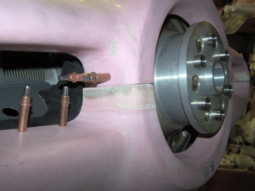

Brief Description:  Cowl 20 - Forward Join Not Flush
The final bit of work before priming was to obtain a smooth forward join between the two halves so I used two layers of 6 x 1 " tape all the way round the lower cowl and two 3"x 1" tape over the forward face and then faired that in with some filler.
Forward Join Not Level
