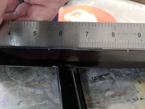

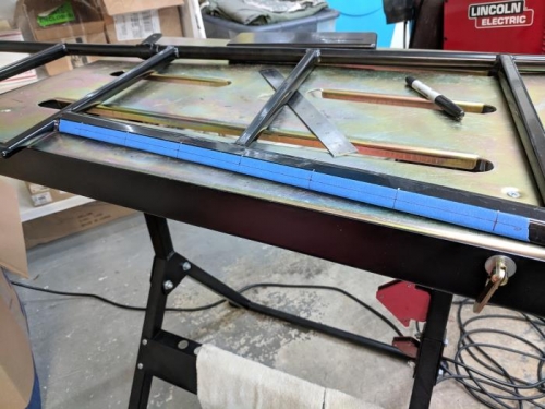

Marked the Right elevator trim attach rib for anchor nut location. Discovered a slight blow in the rib with a straight edge. I'll plan to shim with washers as needed to prevent binding in the piano hinge.
Marked per plan spacing
