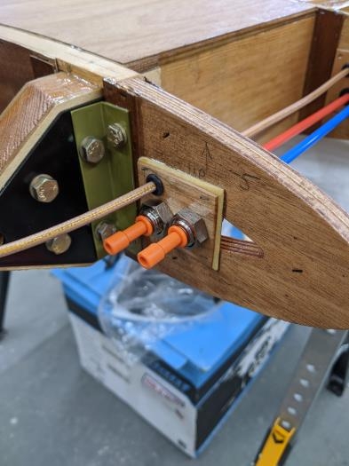

Brief Description:  Installed pitot-static bulkhead fittings in root r
Installed pitot and static QD bulkhead fittings in the left wing's root nose rib. Used orange lock=tite on the B nuts to secure them against vibration. Still need to leak check the 2 lines with all the fittings.

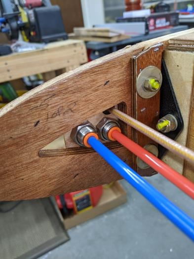

Secured jam nuts with Orange Locktite
