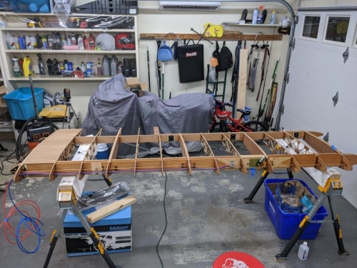

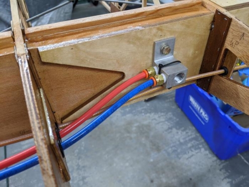

Brief Description:  Pitot-static and ads-b plumbing left wing
Bobby and I installed all the plumbing grommets then pulled the pneumatic lines and connected them at the pitot block. Pulled the RG400 coax last which took an hour to get the 18ft through all those grommets.
Bobby pulling wires and tubing!
