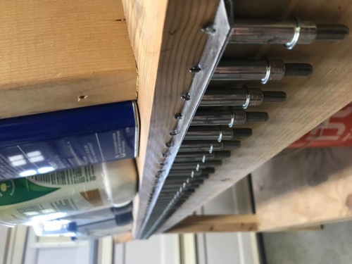

Date:  3-18-2018
Number of Hours:  1.00
Manual Reference:  7-6
Brief Description:  Bend rudder skin trailing edges
Bent rudder trailing edges using a hardwood block with a slot cut in it as described by Vans in their practice kit. Worked very well making several passes applying heavier pressure with each. I should have reassembled the rudder to verify if the bends were adequate. There are a few areas that could have used more most notably the very top of the rudder as you can see pictured.
Deburred all remaining holes.
