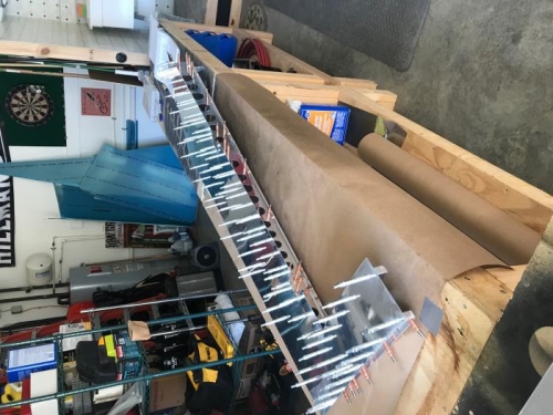

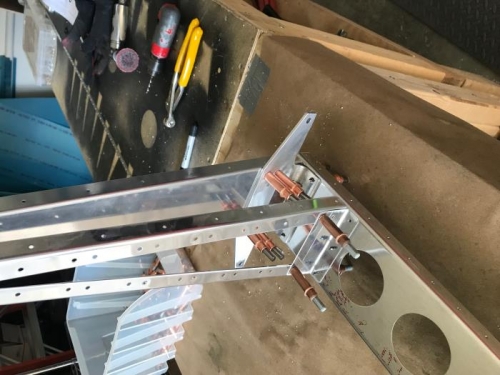

Drilled and deburred rear spar and countersunk striker plates. Assembled and final drilled all stiffners and upper and lower reinforcement plates.
Attached then final drilled counterbalance rib.
Deburred LT & RT rudder skins.

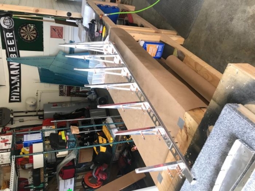

Trimmed trailing edge to fit.
Attached rudder skins and final drilled all holes common to skins and rudder skeleton.
