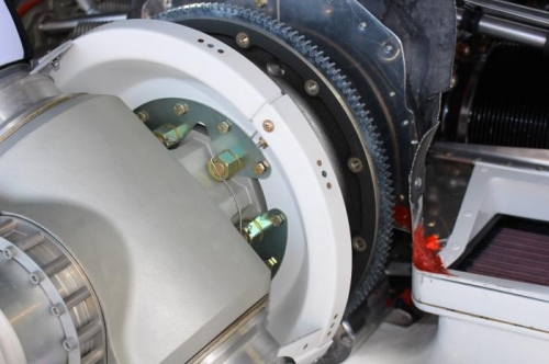

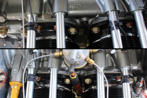

Added star washers behind ignition loom screw nuts; torqued and sealed. Reassembled spinner backing plate. Removed zip ties from preheater wire harnesses on pushrod tubes; wrapped tubes with fabric tape and secured wires with new zip ties.
