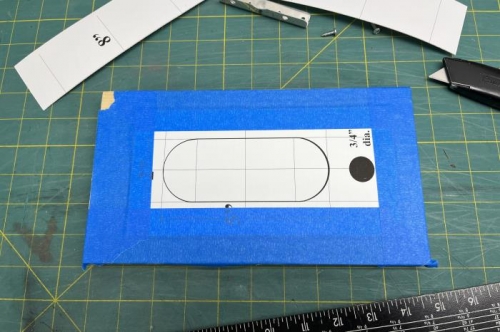

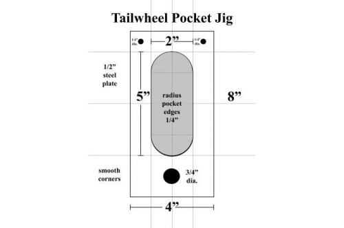

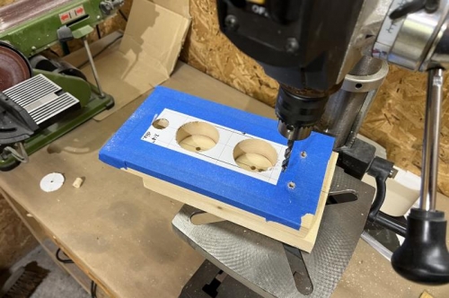

Designed a tailwheel pocket jig. This will be fabricated out of steel for use as a trailer hitch adapter plate for towing the aircraft. It will also serve as a top plate for a tailwheel support stand. Fabricated a test piec out of wood.
