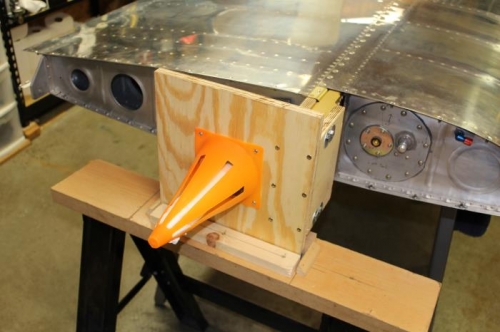

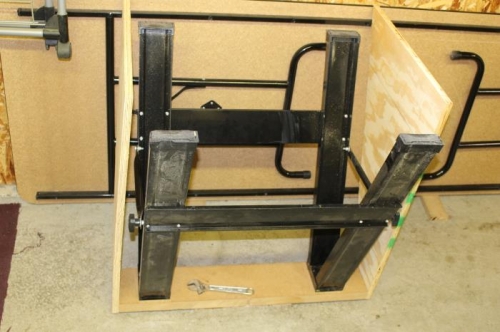

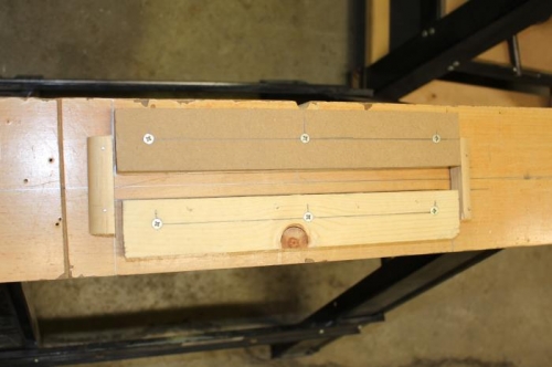

Attached wooden cleats onto the top of another sawhorse to form a notch for the spar rotation jig. It became evident that the sawhorse legs would not allow clearance for the aft tip of the wing at the root as it was pivoted into a vertical position. New plywood legs were cut to hold the sawhorse crossmember at the same height. They were screwed to the crossmember and the stock legs were removed.
