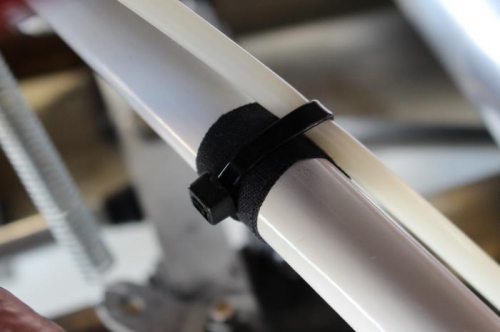

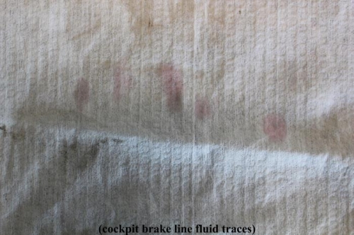

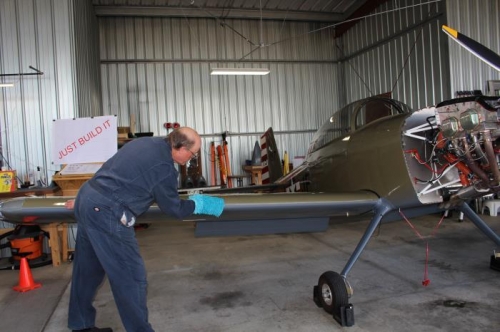

Checked brake line connections in cockpit for seepage. Still slight signs; exact locations difficult to determine. Checked for oil leaks firewall-forward. Manifold block much better; retorqued one Allen set screw. Wiped down all components; oil seepage continues from fuel pump assembly gaskets. Fuel pump vent tube rubbing on fuselage skin; cut zip tie, wrapped fabric tape on engine mount tube and resecured vent tube in better position. Washed down all leading edges and windscreen.
