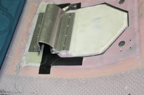

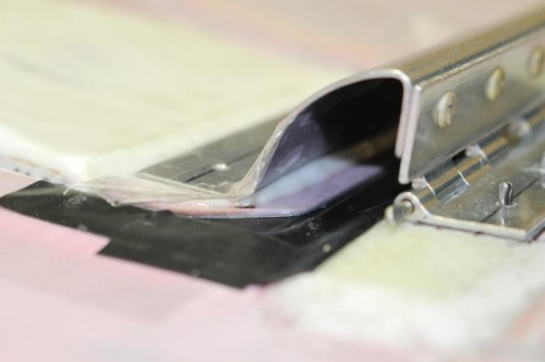

Date:  3-26-2020
Number of Hours:  1.50
Brief Description:  Cowling Work pt. 54
Masked edges of oil door opening with packing tape; taped door to cowl and masked inside edges of door with electrical tape. Masked door side hinge strap with packing tape and assembled door hinges. Mixed flox and applied to inside upper section of oil door. Gently pressed door side hinge strap into flox to create a flat smooth mounting boss; clean off excess flox and allowed to cure.
