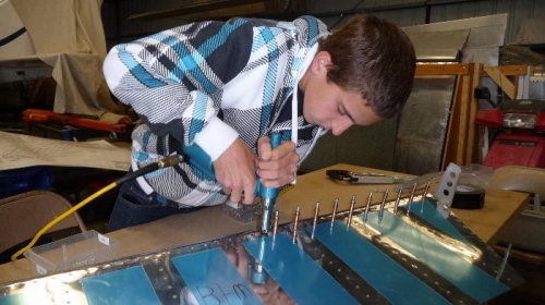

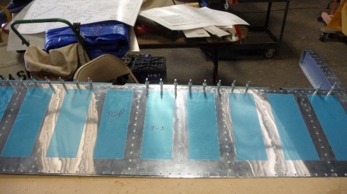

Riveted the top skins of the elevators, squeezing those rivets that could be reached, and bucking the others. On the flip side, it was countersunk blind rivets all the way.
The top skin main spar with as many rivets squeezed as possible, the rest bucked.
The bottom skin is blind rivetted with a pneumatic squeezer.
