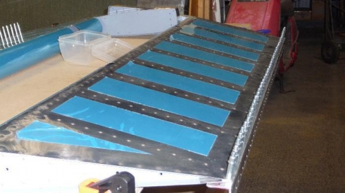

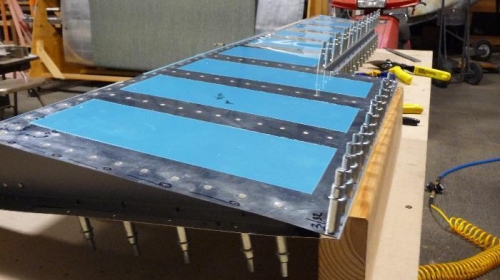

Brief Description:  Elevator trailing edges
Match drilled the right elevator skin to the aluminum angle clamping piece. Match drilled and countersunk the aex wedge. Using a straight piece of 2x4 as a clamping surface, match drilled the trailing edge of the left elevator and wedge. Dimpled the skins and countersunk the wedges.
Left edge clamped to board.
Right trailing edge clamped to aluminum angle.
