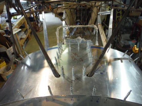

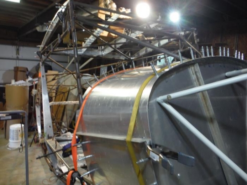

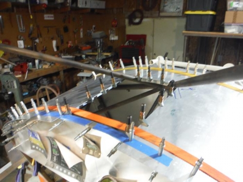

Brief Description:  Boot Cowl Top Panel
Started to locate screw locations for top boot cowl panel. Have to match with center section of engine cowl center section which will be 13" wide to allow for O-540 oil door. Bob specifies 6 screws each end of the engine cowl center section. Drilled firewall
Made angles for center removeable panel. Trimmed top panel to final length.
Made removeable center panel and drilled in position with Jeff's help.
