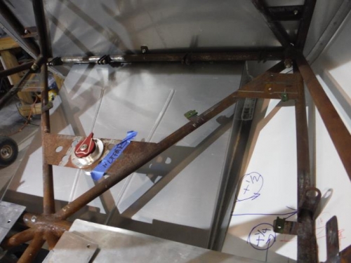

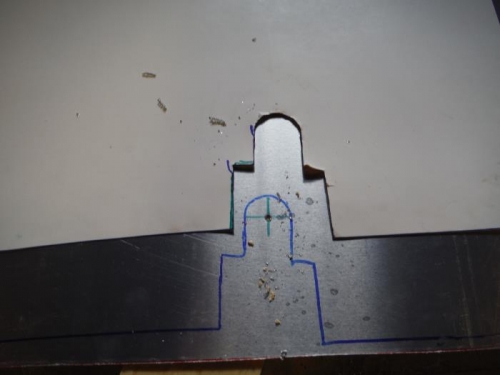

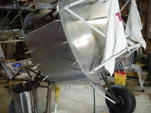

Worked on lower right side of boot cowl. Bottom edge of seam will be on fuselage center line.
Estimate on fuselage center line dimensions:
STA BP = 3 1/2" down
STA AQ = 5" down
Trimmed, fitted, drilled and clecoed in place.
