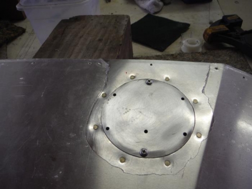

Second gascolator access plate
Made second gascolator access plate and support ring.
Support ring is .032" 2024
Access plate is .025" 2024
Installed nutplates and riveted to bottom panel
