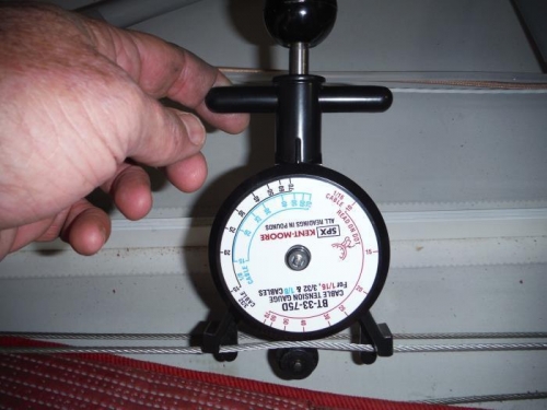

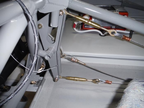

Installed elevator control cables. My adhoc technical counselor loaned me his cable tensiononmeter.
Tensioned to 52 lbs @ 45 deg F with 3 threads showing on the turnbuckles.
Still have to safety wire turnbuckles.
