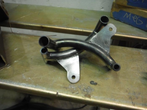

Brief Description:  Brake pedal cylinder mounts
Welded brake cylinder mount on brake pedals.

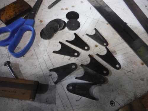

Decided to make another set of lower brake cylinder mounts at fuselage. That way no welding on fuselage would be needed if co-pilot brakes are deemed necessary.
Made disc for ends of rudder pedals per Avipro service bullentin 17MAY2005.
