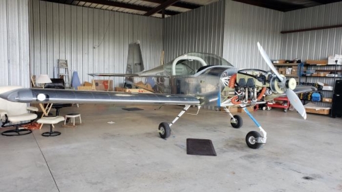

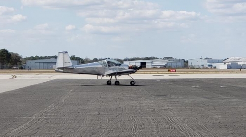

Uninstalled seat pan, found hardware and installed the control stick and crotch strap for the seat belt. Sill need to do the co-pilot side. Lori and I moved the plane outside. Started it up and did the ADAHRS vibration test (pass) then I taxied out to the ramp area and performed the magnetometer calibration routine. Also a pass. Saved settings and rebooted displays. Checked engine after, no leaks
getting ready
getting ready
turning a slow circle
