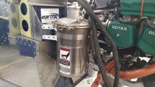

1. The oil tank was installed onto the firewall using the two band clamps.

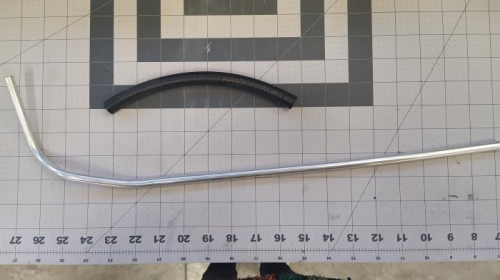

2. A piece of H177 Hose was cut to 8".
Worked on step 3.
01/29/20: 0.58Hrs
3.FF-1219-1 was clamped to the tank and to FF-1218-1.
02/05/20: 4.16Hrs
4: FF-1219-1 was placed over the stem on the oil tank and clamped to it.
5: FF-1218-1 was inserted into FF-1219-1 and clamped as well.
6: FF-1218-1 was bent to follow the stiffener on the firewall and was clamped to it.
7: FF-00022 and F-00023 were attached to the oil tank.
