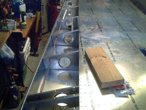

Brief Description:  Wires Run in Left Wing

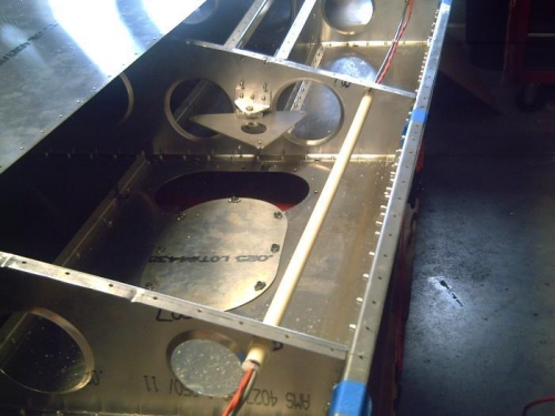

Ran wires for Nav, Strobe, Landing, Wig Wag Lights and Aileron Trim. I installed a piece of CPVC pipe from RR#6 to RR#7. This will keep the wires away from the aileron bell crank and cables.

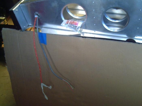

The wires exit near the wing root back channel since all of my fuselage wiring is routed from the control panels via the center arm rest section to the rear.
