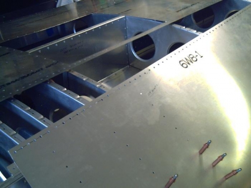

Brief Description:  Left Wing Upgrade Work
The upgrade calls for doubling up on the rivets in the top and bottom wing spar from the root out to Rear Rib (RR) #5.
Well yours truly made another oops; I doubled up out to RR #6. So I called Zenith and talked to Rodger, he told me that there is no problem with this. He did suggest that I do the same on the right wing so that it looks the same.
