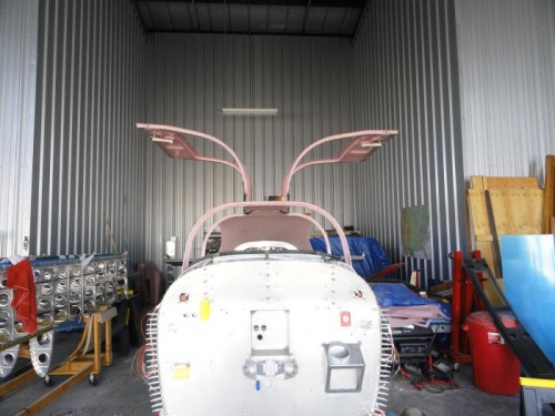

Brief Description:  Finish installing pilot side door
This went much like the other door. I cut the latch pins to length and then filed and fit until the machined pins clocked to the correct position. Next I fit the strut bracket using the jig I made last time. Finally, I installed the strut for a test and then marked the position of the flush latch. Now the cabin top can be removed for the overhead console work and finishing work on the doors.
