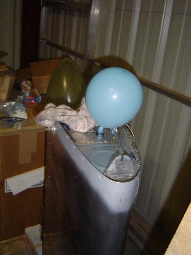

At the EAA Chapter meeting, installed the left fuel tank sender and end plate. Then installed a balloon and pump for pressure test and inflated the tank for overnight test.
