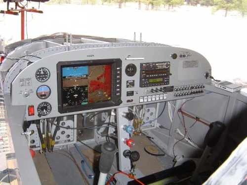

Brief Description:  Autopilot troubleshooting, engine controls

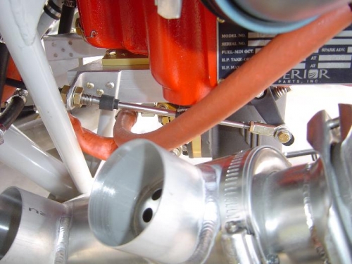

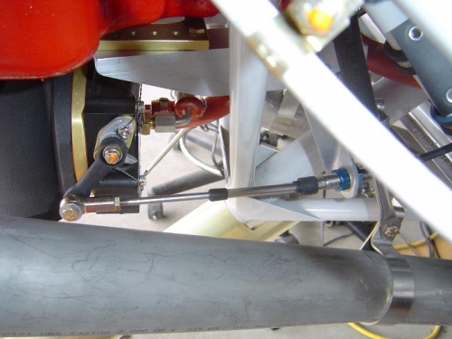

Replaced fabricated autopilot communications cable with BMA supplied one (short cable required removing the baggage bulkhead and running direct from panel). Autopilot ops-checked fine; will contact BMA to find out why. Installed the throttle and mixture cables and ops-checked them; still need to finalize routing within cabin area. Fabricated fuel line from Floscan to throttle body and installed.
