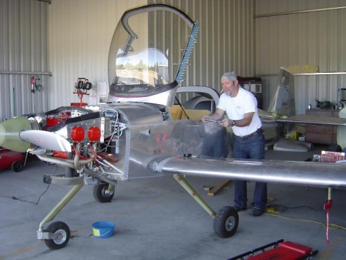

Brief Description:  Adjust tachometer, set idle speed
With help from Jack Keegan and Nelson (?, an A&P based at KFLG), I adjusted the tachometer readout to match a calibrated hand-held tach. We then set the idle RPM to 650 (at 7k', should be around 750 at sea level). I then verified rudder/elevator/ aileron control stops.
