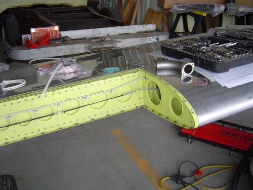

Brief Description:  relocated gps antenna to wing, oil filler door

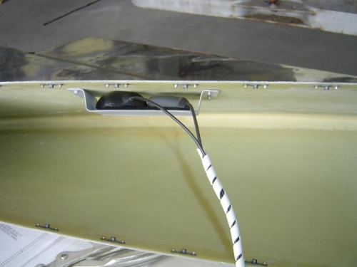

Routed GPS antenna for both ADI and EFIS to left wingtip. Used 3/8" conduit and spiral wrap to protect new routing. Created shelf for mount in wingtip and mounted the antenna to the shelf with velcro. Ops checked the installation to be sure the antenna would work under gel-coated fiberglas. Reconnected strobe and nav lights, reinstalled wingtip, and ops-checked lights.

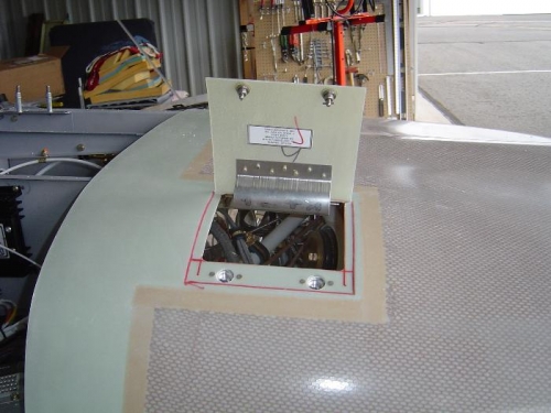

Installed camlock fasteners for oil filler door closure. Riveted hinge to cowling and door and tested operation of hinge and camlocks.
