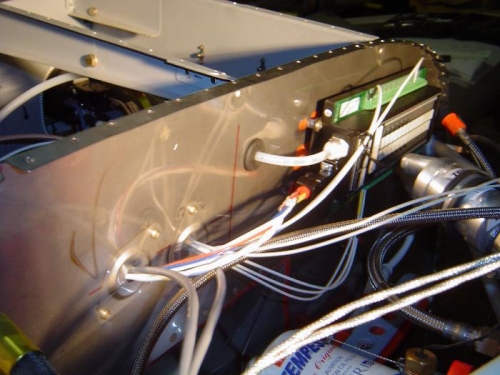

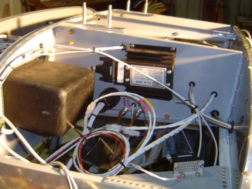

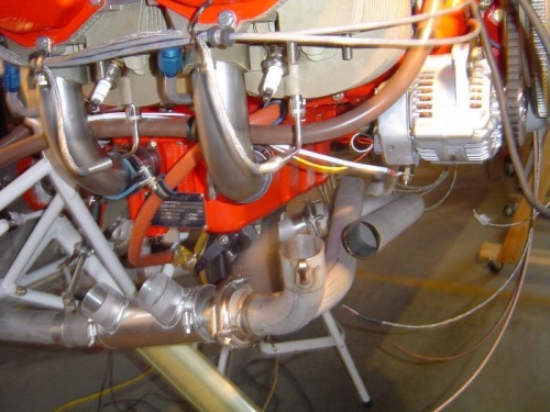

Brief Description:  Finished main power connections and engine pod cab
Fabricated the alternator cable and also connected the shielded alt field cable to the supplied plug. In routing the cables, removed the exhausts and installed clamps for prop oil line and injector fuel line. Inside the cabin, cleaned up passenger side routings and added magnetometer connection. Also fabricated cabling for the Engine Pod and connected it along with current sensor and rpm line. Ops tested the engine pod on the EFIS display.
