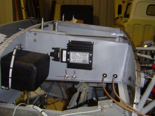

Date:  6-6-2008
Number of Hours:  5.00
Brief Description:  Routing of Lightspeed ignition wiring

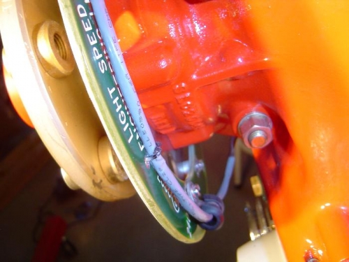

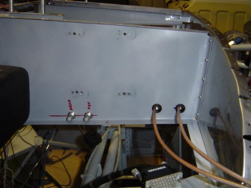

Removed right forward baffle and routed ignition sensor cables to right side of engine (installing adedl clamp on sensor board to maintain clearance from case). Sensor wires will be clamped at baffle and will enter firewall at rear of engine to avoid power lines. Located holes and snap bushings for coax exiting Lightspeed ignition boxes. Also located antenna couplings and dimmer unit. The latter was secured with screws and nutplates.
