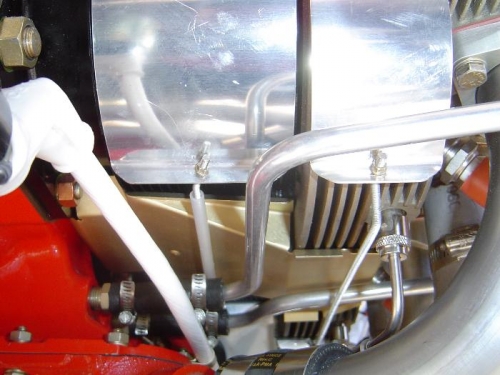

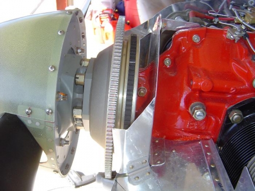

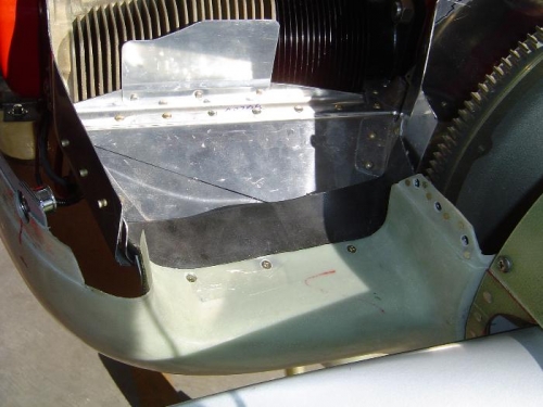

Baffle construction, safety prop
Used threaded rod to create tension rods for the baffling and installed in all four locations. Cut baffle seals for intake area, fabricated backup strips, and drilled and installed with screws. Saftied the prop bolts,
