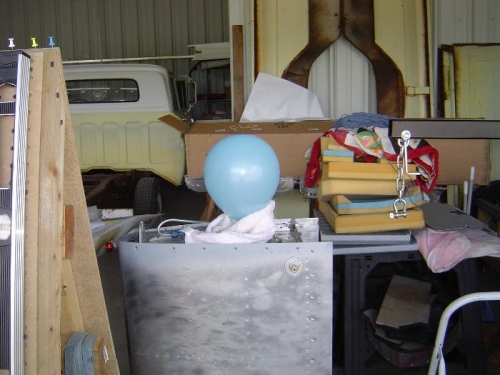

Right fuel tank still holding pressure; removed balloon and pump and installed sender and end plate on left tank. Installed pump and balloon and inflated for overnight pressure test.

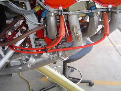

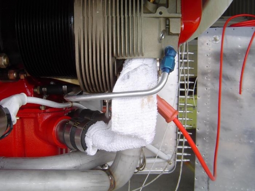

Fabricated spark plug wires for lower right plugs, using straight connector at plug and 90 degree at coil. Routed wires to coil using seperators and clamps on engine mount. Removed front left intake manifold tube so that CHTs could be repositioned to run straight aft. In replacing the tube, I inadvertantly over-torqued one bolt and broke it. Decided to stop work at that point and requested replacement from Superior Air Parts.
