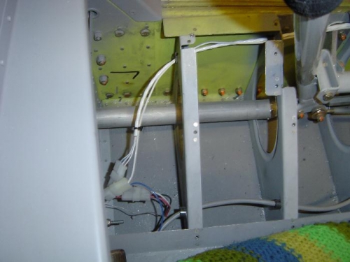

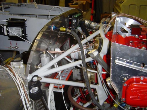

Brief Description:  Wiring from wing spar forward/manifold pressure ta
Ran wiring for landing lights/nav lights/pitot heat/marker beacon antenna/nav antenna from behind wing spar to just aft firewall. Made up molex connectors for power wiring; BNC connectors for antenna. Cleaned up wiring runs and use spiral wrap on main bundle to prevent chafing from rudder cable. Installed firewall bulkhead for manifold pressure line and installed the fitting on the engine. Finally, installed the line between the two points.
