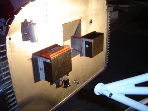

Brief Description:  Firewall penetrations and remount engine

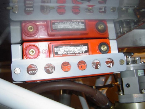

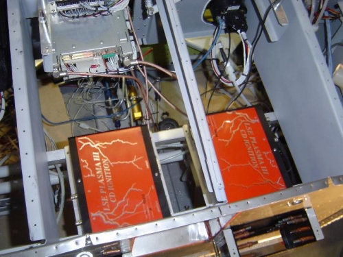

Riveted both battery boxes and installed platenuts for their installation. Installed both boxes on firewall. Fabriated rail to mount Lightspeed Ignition boxes; located rail in area aft of firewall and located and drilled mounting holes (waiting for platenuts to finish installation). With the help of Jack Keegan, restored engine mount to firewall. Located batteries in their boxes, fabricated mounting straps, and strapped the right battery in (waiting for nutplates - missing from kit - to finish left box).
